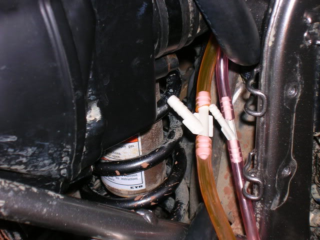

1) What carb line do I put the "Y" fitting on?......there are 2 lines...one on each side of the carb...is it the throttle side pink line?

2) Hot as it comes out of the tap. Don't boil it and no need to put water on a stove to get hotter...Hot tap water is perfect...
Thanks DirtSurfer, I have your install printed out and have it ready for reference. I have read it probably 8 times and I really appreciate you doing the how too.I noticed in that thread that you did both lines but I swear I read a thread somewhere that they did only one-line.
I guess One line is pink and the other is orange...apears to be different size I.D. too.
Thanks for the tip on the water, I didnt figure it was boiling but I wasnt sure the water from the tap washot enough...lol
