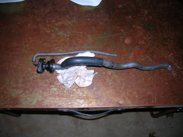

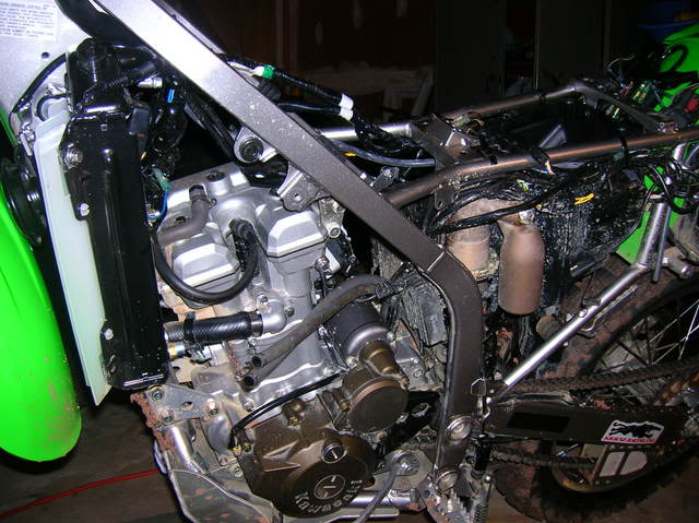

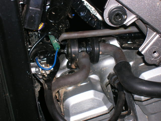

Once I got the seat, srouds and gas tank off, my first job was to get rid of the smog crap (KCR Air Suction System).
Attachment 33071
after I got that bad boy off:
Attachment 33072

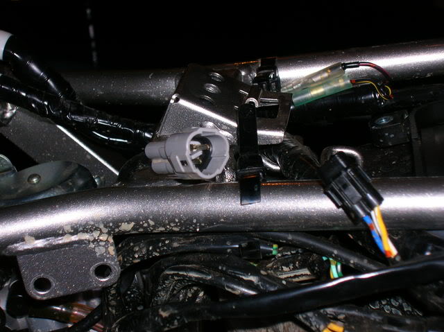

It was time to get the Carb out. following the above site's instructions, I detached the Carb TPS system at the connection:
Attachment 33073

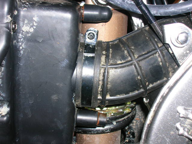

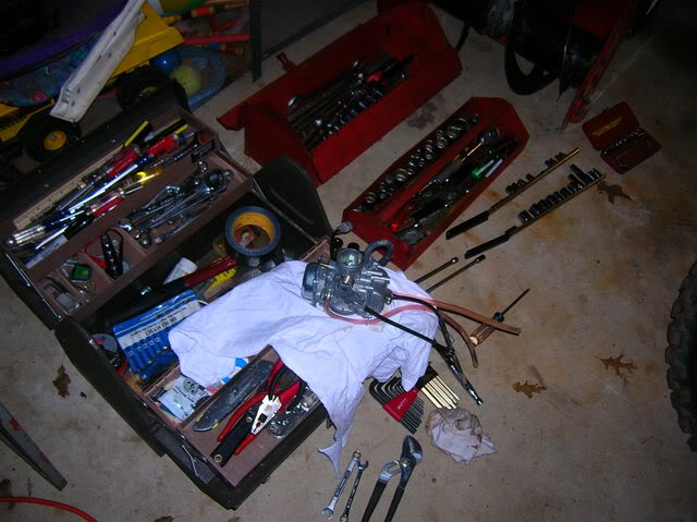

I was then able to undo the soft plastic boots from the air box and engine intake and pull the carb right up through the hole where the seat was.
Attachment 33075

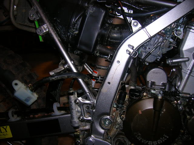

This is what the Carb should look like with the proper tubes and wires attached when you take it out:
Attachment 33076

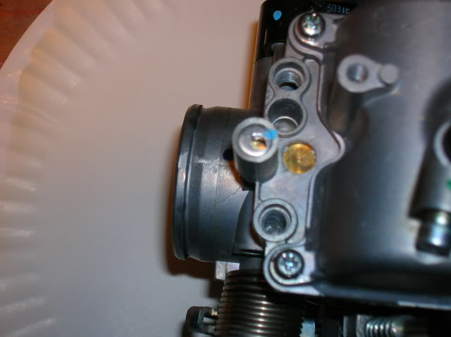

The first plug I did was on the carb, plugging the carb vacume port to the KCR Air Suction System.
Attachment 33077

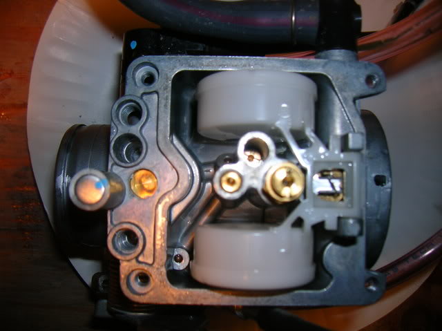

Next I took off the float bowl and changed out the stock main jet (right) toa #130 and the pilot (center / inbedded) toa #40.
Attachment 33078

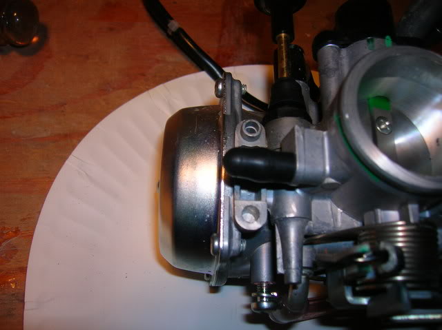

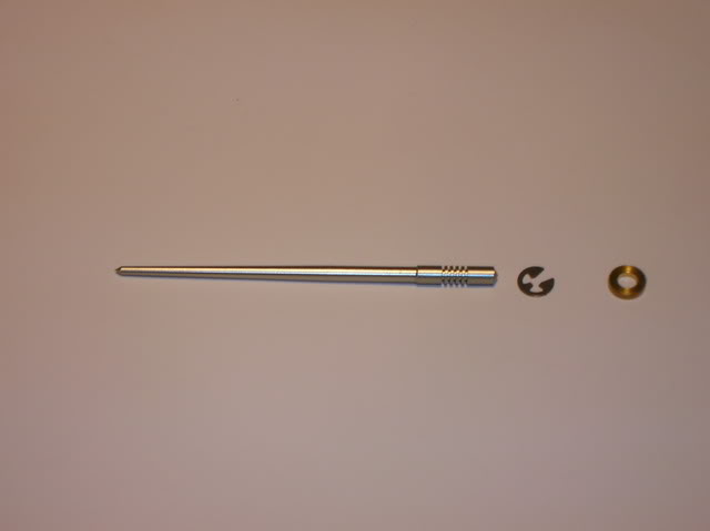

Once that was done, I replaced the float bowl, turned it over and quickly opened the slide housing, drilled the slide breather hole 7/64ths and tossed the slide in hot water to keep the diaphragm from expanding. I got the new needle ready, with the clip on the second notch with the collar.
Attachment 33079
I pulled the slide out of the hot water, dried it off, and put it back in the carb. then droped the needle (with clip and collar in place)into the slide (making sure it went into the main jet holder) and then put on the plastic spring holder, the spring and put the top back on. I did this quickly to avoid the diaphragm expanding. The hot water worked great, and it stayed the correct size.

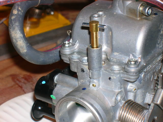

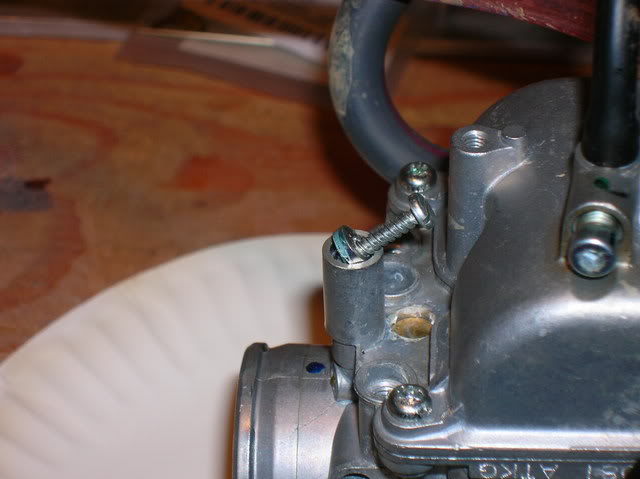

Next I turned the carb back over (upside down again) and poped out the pilot adjustment screw cap by drilling it very carfully, then using a screw to pop it off:
Attachment 33080
Attachment 33081
Attachment 33082
Once the cap was off, I screwed the screw in all the way to see what it was set at. (1 full turn).

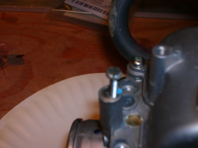

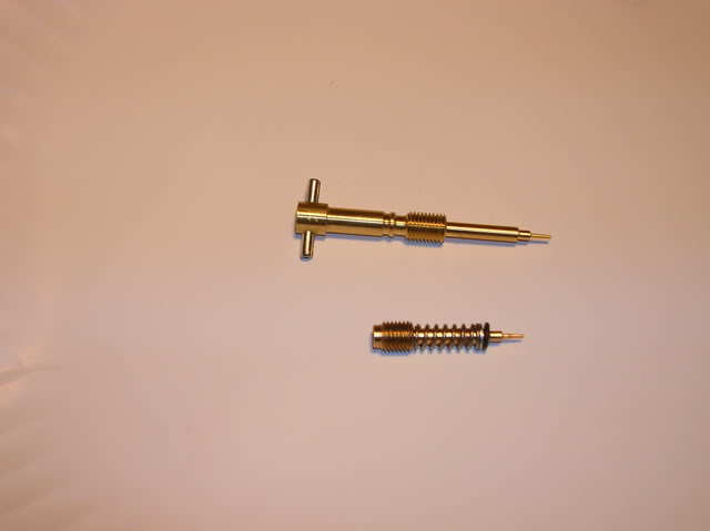

I then took out the screw and replaced it with the Kouba adjustable screw for easy adjustments once the carb is back on:
Attachment 33083
Attachment 33084

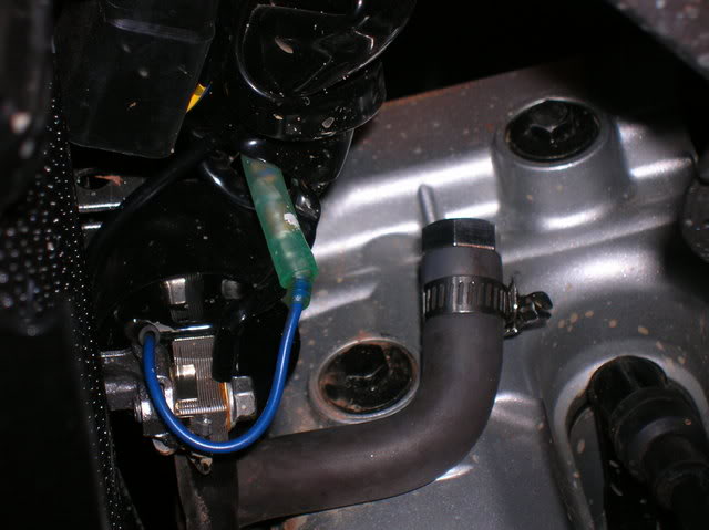

I ended up leaving the entire piece of tubing from the KCR Air Suction System from where it attached to the exhaust manifold to where it had attached to thesensor. This way I figured I could put it back together if I had to for inspection. In the meantime, I simply used someone elses great suggestion and put a bolt and circle clamp on it so that it would be sealed but not melt like a cap might that close to the engine head:
Attachment 33086
Attachment 33087
I then just tethered it to the wire harness above so that it wouldnt rattle when I was riding.

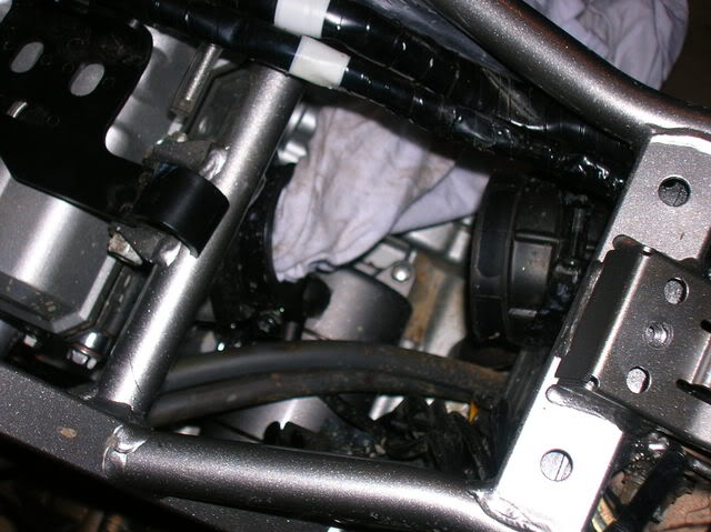

Next I sealed up the vent holes in the air box, one with a cap outside (forthe KCR Air Suction System hole on top) and one with a cap inverted and pushed inside (for where the crankcase vent hose used to be) for both, I used a sealer to keep them air tight and in place.
Attachment 33088

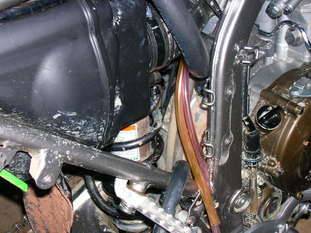

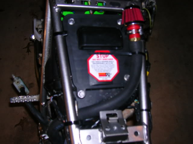

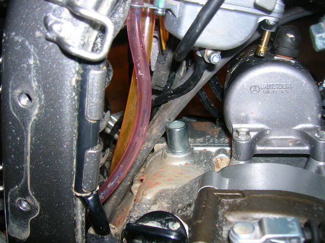

I then had to re-route the crankcase vent to the top of the air box ala the "Nobrakes" method since that method allowed the crankcase to still get the air it needs (vs sealing it off) and also put the opening way up top, so short of full submersion, there should be very little water getting into the engine crankase!!
Attachment 33089
I ran a 5/8ths inner diameter tube up from the cankcase opening and put it aside for the time being soI could finalize the airbox filter and lid assembly. I was having the darndest time getting that air filter box to fit......;)

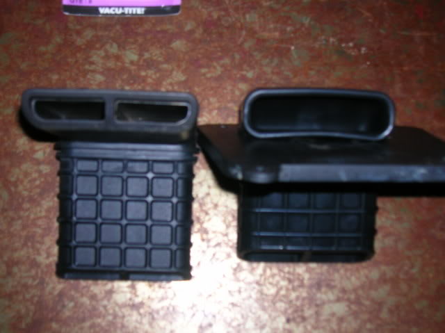

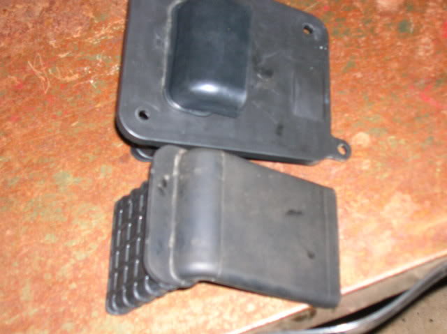

Man what a differnance the High Flow snorkel makes!! It lets so much more air in due to the much larger openings and much shorter distance that the air has to travel compaired to the stock snorkel...
Attachment 33091
Attachment 33092

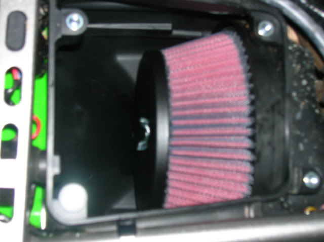

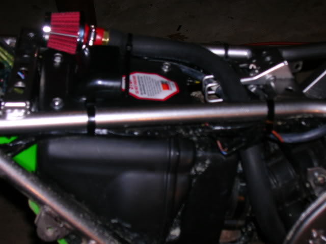

Eventually I got that K&N air filter in!!
Attachment 33093
And with the lid attached again sporting the High Flow snorkel, I was ready to "Nobrakes route" the crankcase breather:
Attachment 33094
At first I routed it incorrectly accross the base of the frame where the seat clips in, I later had to change that position but was still able to stay up top!!

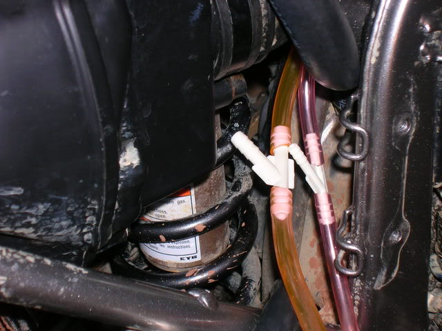

Next on the list (based on access still available!!) was completing the Carb breather "T" mod. This was very strait forward and I ended up using a Y connector from an Autozone store along with some windshild washer 5 mm tubing:
Attachment 33097
Attachment 33098

The air screw is "T handle" mixture screw from KoubaLink
If you use this site:
http://www.koubalink.com/fuelscrew.html
Just order the one for the KLX250 ( I don't think they have part numbers) Theowner is GREAT to work with and its a breeze to get. (yeah, there was NO WAY i was going to have to take all that appart for small adjustments to the fuel screw!!----SCREW THAT!!!)
