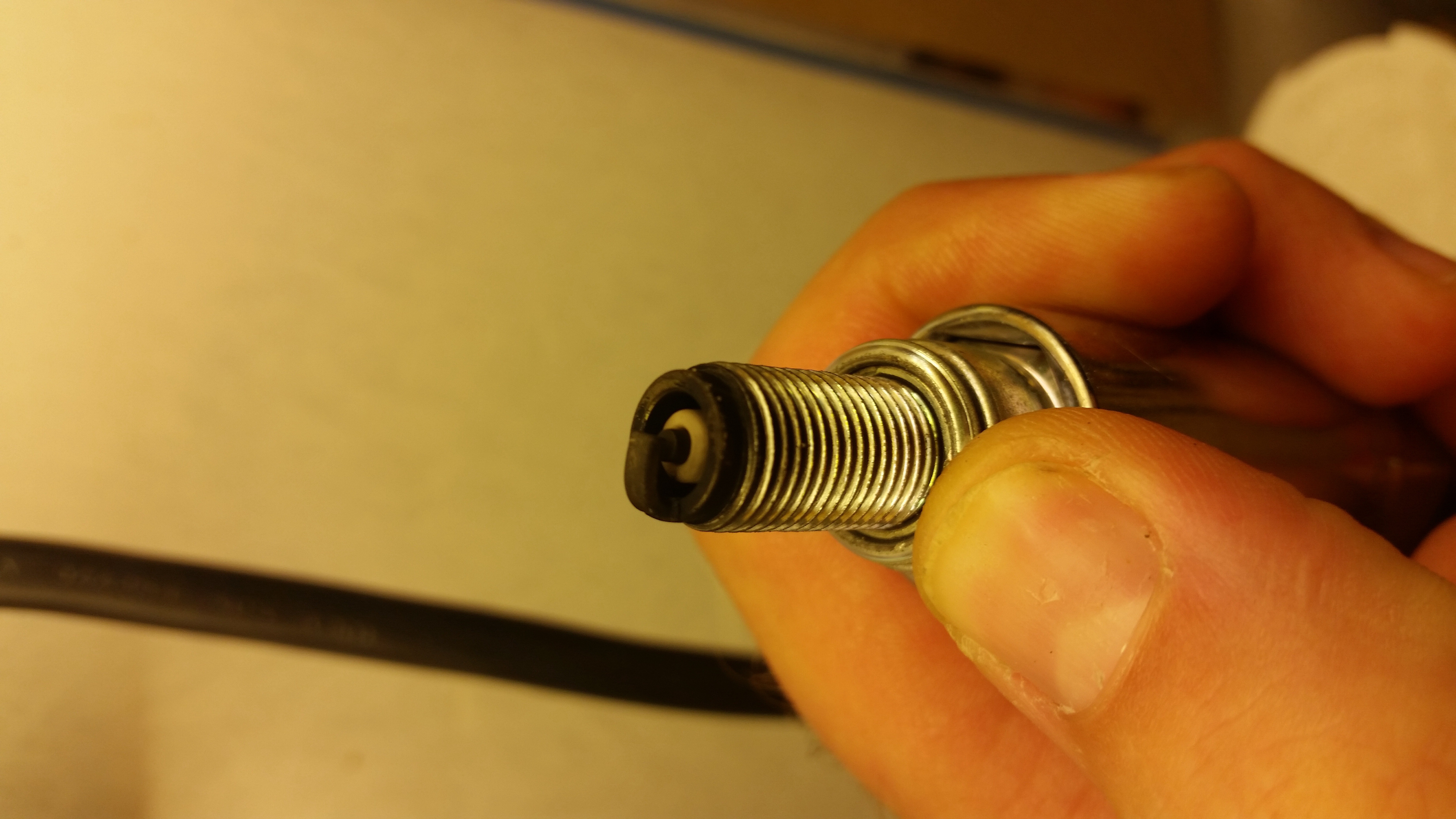

Pic of plug after about 50 miles attached..

best bet will be to up the needle a notch or two. It'll richen up the mid range and top end. It's also free and easy to do. Just pop the tank off and open the top of the TM, adjust the needle and put it all back - 10 minutes.
Not many people run anything more than a 130 main jet even with a 351 from what I've seen. That being said, untill KLXster did the dyno charts everyone was perfectly fine using 120 and 124 main jets on their bikes at sea level... so.. who really knows without an AFR gauge.
try the needle on the 4'th notch or even 5'th and see what happens. Test it out, get it hot. TM's are temperature finiky. Seriously ride for at least 15 minutes and work it. Then check your header. If it's better and the mid range feels a lot stronger than the top end, you can go with a 132.5 main jet and dial the needle back to where it was.
Also if you don't want to try changing main jets, you can try the P6 Needle jet. I had the AFR gauge on my stock bore when I tuned the carb and the P6, P4 noticeably leaned the bike out in all rpm ranged. I had issues with consistent fueling with the P6 but I think that's due to the lack of a perforated needle jet that 4 strokes generally have. The Solide needle jets are typically used on 2 stroke applications from what I've read.

Are you still running the Air Injection System ? Don't go near that carb until the Air Injection System is removed and capped off.. "Cherry Red Header" is caused by this system..
Also, are you forcing your 351 to suck through an airbox lid ? If so, you might want to consider not doing that..

But wouldn't removing the lid introduce more air, making it even leaner?

Almost all single wall exhausts will glow red even orange if left sitting and idling for several minutes. Exhaust gasses are around 1300-1500 degrees, more than enough to get a good glow going. It only takes about 900° for steel to start to glow red. The cool air when riding will cool it below a glow.
I had a well jetted SR500 single glowing bright red in sub-freezing weather when I let it idle for about 8 minutes or so to warm up. Within less than a quarter block it was no longer glowing.
It isn't unusual and it is not a sign that the bike is running too hot. That is found with spark plug readings in absence of any sort of instrumentation for more accurate readings. Temperatures at the exhaust valve can be between 1200-1800°F. Plenty warm enough to create a glow on a steel pipe without any air circulation around it.
