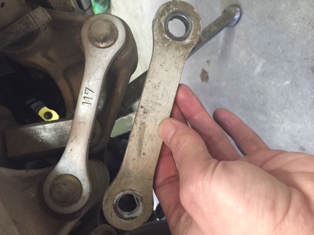

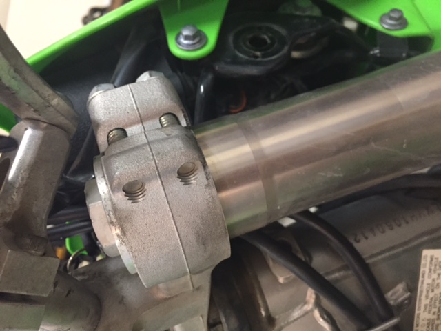

Cleaning up/modding a used 2006 I just picked up and noticed the PO included some links in the bag of stuff. Not sure what's on the bike now...stockers or lowering links? I included a pic as well as a shot of the forks position. Looks like by the marks on the forks they were slid higher at some point to lower the bike so I am assuming right now the bike is stock height but wanted to confirm it with the community...

Mines an 07 and it has the same 117 links stock and the fork in that position. Put the link on that is in your hand and the back end will be lower.

Pretty sure the shorter link set will be the stock set. I believe longer ones lower it.

100% the one that's on there with the 117 stamped on it is the OEM link.And the forks are in the stock position.
