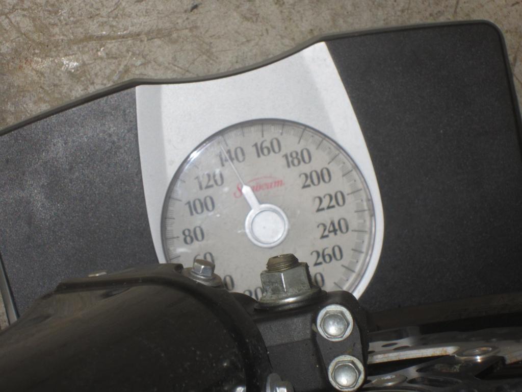

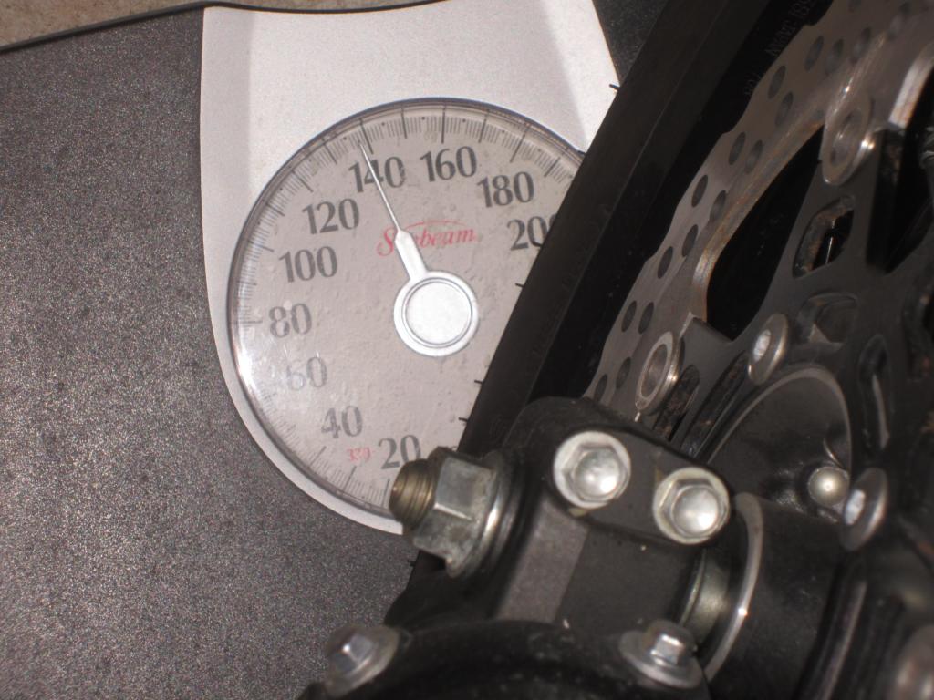

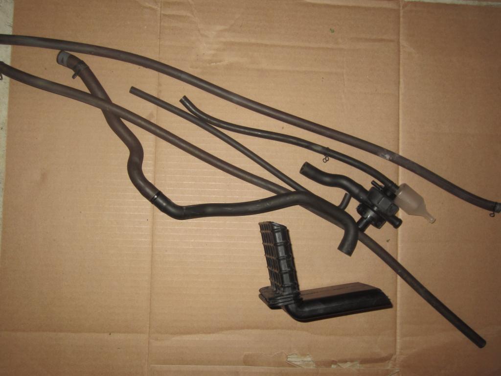

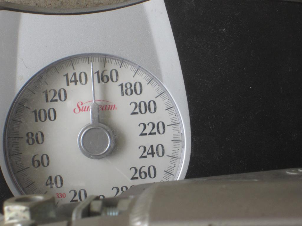

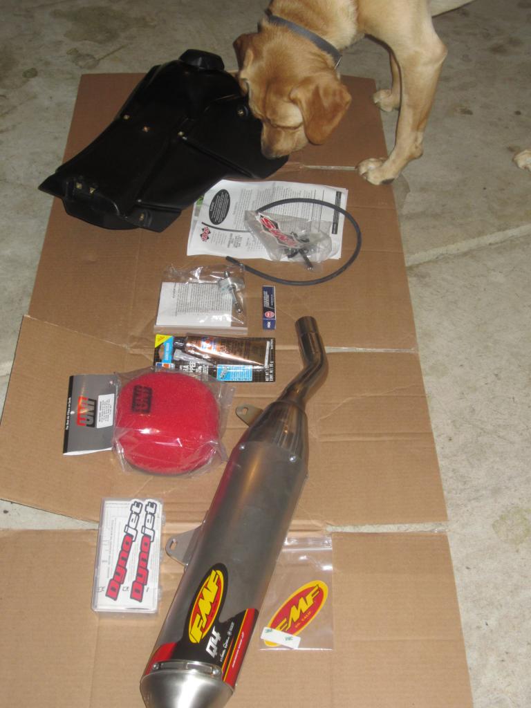

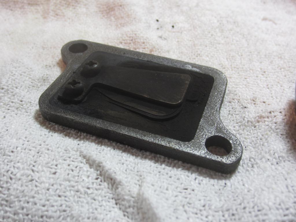

I finished the next phase of upgrades last weekend, including IMS 3 gallon tank, FMF Q4 slip-on, Dynojet jet kit, Krieger Cam Chain tensioner, and a few other small parts. There are already well written reviews and install guides for all these parts, so I'll just share a few interesting pics I took during the upgrades: New parts undergoing inspection: Attachment 9424 I used an old bathroom scale to get before and after weights of the bike when installing the above parts. I know it's not the most accurate method, but should at least give a ballpark estimate on weight savings. Attachment 9425 http://i10.photobucket.com/albums/a1...ps565ffe45.jpg Initial weights front (138 Lbs) and rear (156 Lbs) = 294 Lbs with maybe 1/2 Gal of fuel left. Attachment 9426 Attachment 9427 Final weights front (137 Lbs) and rear (152 Lbs) = 289 Lbs with about the same 1/2 Gal of fuel. About five pounds knocked off, most of which was the exhaust swap. The new IMS tank may have been slightly lighter than the stock metal tank, but not detectable on my crude scale. Other saving came from ditching a bunch of emissions crap and the air snorkel. I took apart the exhaust air injection reed valve and modified it so it couldn't open any more, then capped off all associated ports. This is an easy and free mod I've done to all my Kawasaki's that used this system. Before: Attachment 9428 Attachment 9429 Attachment 9430 After: Attachment 9431 Between the tank swap and air valve modification, I removed a bunch of emission tubing, it really cleans up under the tank and around the carburetor. Attachment 9432 Other upgrades included the jet kit, NGK Iridium plug, and Krieger cam chain tensioner. My pre-mod mileage was around 63 MPG, and on the first post-mod tank it had dropped to about 53 MPG. But I'll continue to monitor and see if it changes on future tanks. At some point later this summer, the KLX will get different handlebars, grip heaters, and handguards. So far I'm really enjoying the bike. Still trying to determine if the old saying "It's more fun to ride a slow bike fast than a fast bike slow." is true or not! |

Nice first posts. Good to see another rider joining in here who has obviously been around the loop a few times. DJ's jetting recommendations, IMO, seem to be on the rich side. Perhaps good for power, but not for best MPG? Keep us apprised. Edit: and nice job modifying the air injection unit. I've never seen a clean job like that one. I just cut the air intake line off short and put a plug in it. Your method is cleaner. |

...nice job modifying the air injection unit. I've never seen a clean job like that one. I just cut the air intake line off short and put a plug in it. Your method is cleaner.
From a ZX6R (stock is on the left, modified is on the right): Attachment 9414

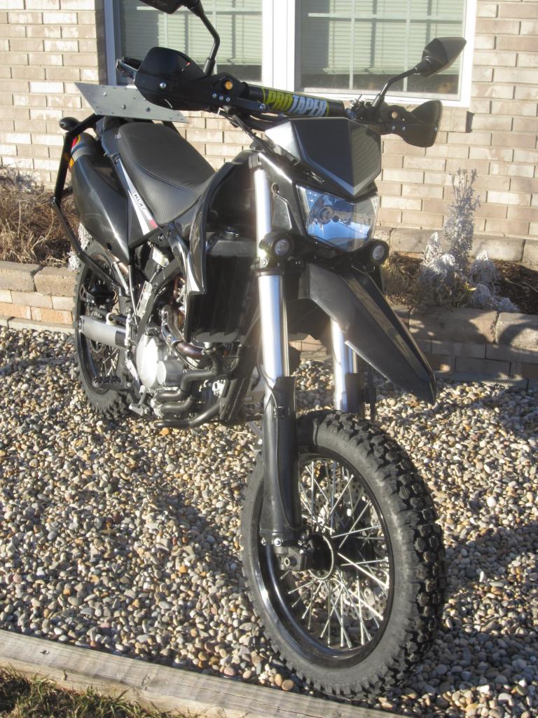

Just wanted to post an update after several months of riding (and modifications). New upgrades since last posting include raising links for the rear suspension, auxiliary LED lights (tied to the high beam), ProTaper bars, bar risers, grip heaters, handguards, smaller LED front turn signals, and Shinko 244 tires. Also fabbed up a custom rear rack for future panniers.
First a pic of the bike in stock trim: http://i10.photobucket.com/albums/a1...psc8122262.jpg As she sits now: Attachment 9055 Attachment 9056 Still getting used to the new rubber and higher stance. Occasionally get to ride to work when it's warm enough. Endured temps as low as the upper 20's some mornings! |
FYI, the new pipe may lead to the turn signal melting. If you are planning on keeping the stock signals, it may be worthwhile buying or making a signal relocation kit.
Google: klx250s turn signal relocation kit. Is it a slow bike? I can't tell, I haven't ridden a wooden local trail yet where I can go wide open. |
That looks bad ass with the knobbies.
Oh yeah, please round the front corners on your rear rack. That could hurt. |
Nice bike! I would love some info on what LEDs and mounts you went with.
Originally Posted by marcham
(Post 517853)
Originally Posted by boatdriver1790
(Post 517864)
2X 10W 2" Round CREE XML LED Work Light Spot Driving Lamp FogLight DRL 12V 24V | eBay Used the included little mounting brackets and ran the bolt for the lower fork clamp through. Might have had to enlarge the hole slightly, can't remember. Actually worked out really well. Definitely not the brightest lights available, but affordable and a good supplement to the factory high beam. |
