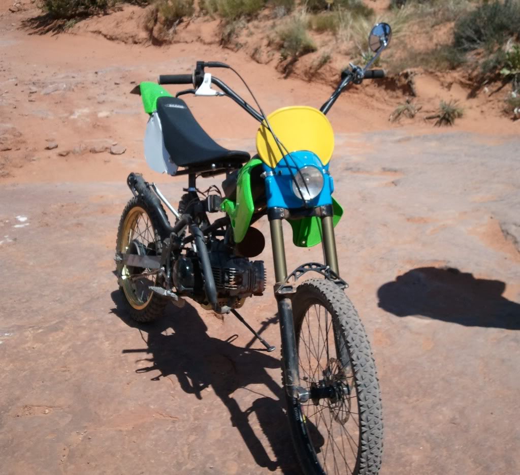

You know, those little motorized mountain bikes we saw on Fins would kick butt for many of the trails.
Attachment 14053
