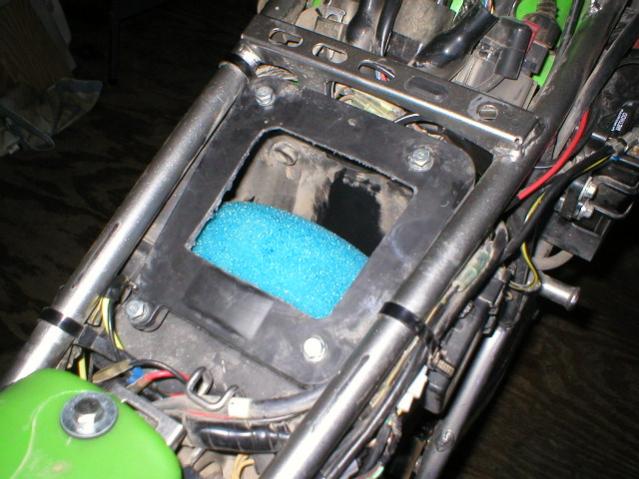

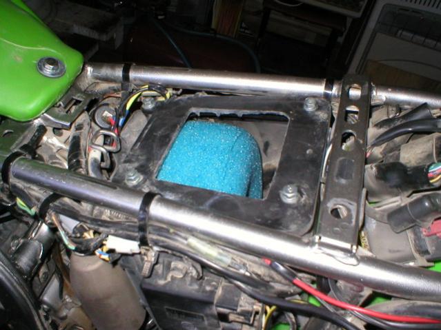

It seems pretty clear from the different responses here that there is more airflow with the airbox lid off. The posts of users who see a difference with the addition or removal of the lid fairly well prove that. It's just that the jetting needs to be aligned with either the lid off or snorkel on depending on your preference. I can see running the snorkel if you don't like the sound of the bike with the lid off.
djchan, your acceleration test is very much like the Mikuni recommendations for final tuning of the main jet segment of the TM36. Of course they're assuming you leave everything else the same so you can choose the best main jet, but the principle of jetting to the speed achieved carries over to finding the best setup for your bike. Your speed would most likely increase with the lid off with the proper jetting to match, as I think you well know, but preferring the sound of the bike with the lid/snorkel on is understandably reasonable.
Open airbox CLEARLY flows more air at the upper 1/3 rpm range at or close to full throttle. I do not think it makes much difference at the lower 2/3 rpm especially at smaller throttle openings.
Because of the overlap in the needle and the main jet, I think it makes it harder to tune the carb with the airbox lid off. What may be the perfect main jet at full throttle near redline may be a tad rich for 2/3 throttle at 7000 rpm for example.

On the snorkel and water/rain, this is why I cut the hole in the lid bigger rather than just run without it. Without the lid the airbox is more of a big cup with its edges waiting to let water rush in more easily in a water crossing splash. At least that's my take on it.
