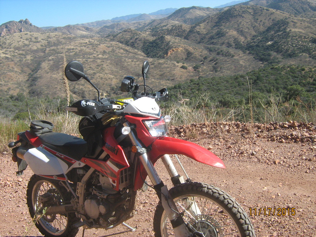

I'm out for a ride up to the top of Red Mountain, a little south of Patagonia, AZ. I'm half way up the mt and the bike starts to feel a little squirrelly. It's a good spot to take a couple of pictures and figure out what's going on.
The following are looking south into Mexico:
This is all nice and a great day for a ride with the temps in the 50's, but I've got a flat. The last m/c flat I had was in 1970 when my Trail 90 wrapped around some barbed wire while being used for deer hunting in Wyoming. Anyway, I go less than 100 yards back down the mountain and the seals come loose, but it's still under control at low speeds so I keep going about 3 miles until I come to the asphalt Harshaw Road where I take the speed up to 10 mph, and ride it about 7 miles back to Patagonia where I try to put air in it, but it comes out faster than what it goes in - here's why:
