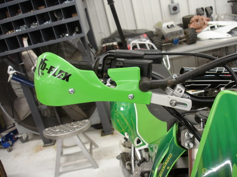

bryantjt, I have the same bars and gaurds (you must have good taste) my guards are black though, anyway. I installed them with the bars on the bike so I could move them around a little more. Put the bar end in first (of course after you install grips) then attach the small slotted peice to the guard arm keep loose. Then put on the bar clamps keep loose, mine arm about 1/2 inch from the handle bar clamps. Then attach every thing together and position and tighten. You will have to move every thing on the brake side to fit but not much. I'm here to help. Tusk gear rocks.
[IMG]local://upfiles/4369/F1E1AB15E0774D089F88422D678CAEA8.jpg[/IMG]

Sorry that was an old picture putting them on is a different story. This is what we wanted.
[IMG]local://upfiles/4369/DDFB80320C9E4C86BF65FF6BD1FB8A57.jpg[/IMG]
