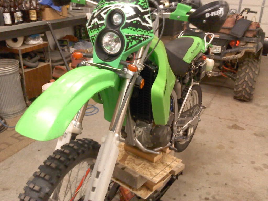

I first tried Tusk brand from Rocky Mountain ATV. Their D-Flex Handguards with Spoilers.
Tusk D-Flex Handguards | Dirt Bike | Rocky Mountain ATV/MC

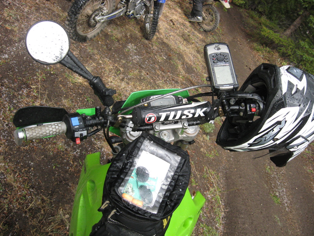

Then Barkbusters went onto the KLX and the Tusks were moved to the KLR. Notice the aluminum bar with plastic protector mounted to it.
Both of these require an insert into the handlebar end to hold the handguard (that looks like this): Tusk Aluminum Handguards | Dirt Bike | Rocky Mountain ATV/MC
Our stock KLX handlebars need to be either drilled out or end trimmed off to install the insert. PITA from what some say. I got different bars.

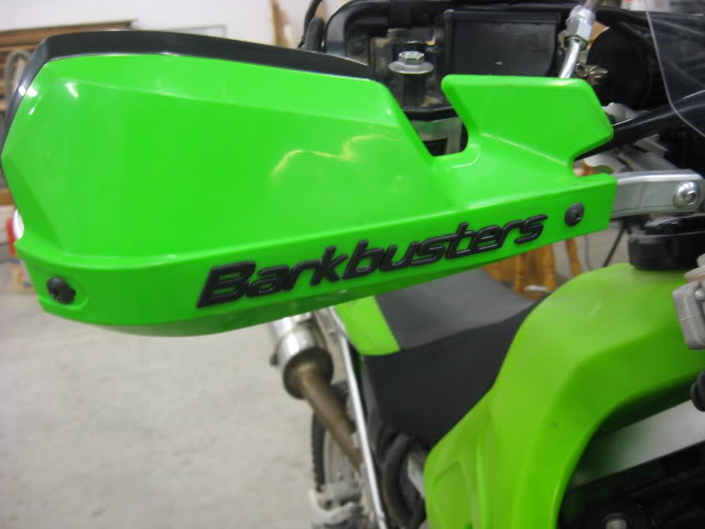

I think those are motocross handuards wich don't actually wrap around your hand and controls. They have one connector to the handlebar and it is very flexible.
Most riders here prefer enduro handguards which wrap all the way around the hands, and completely cover the controls and levers with 2 connections and has a metal brace that attaches in 2 places for greater strength.
Having said that, if you're not riding offroad and only need the guards for wind protection, the MX guards may be the simplest, easiestand cheapest option.
If full protection, go with the barkbusters or similar construction. If you look at the posted picture, the standoff near the triple tube is about 3.5-4" long, this is good.

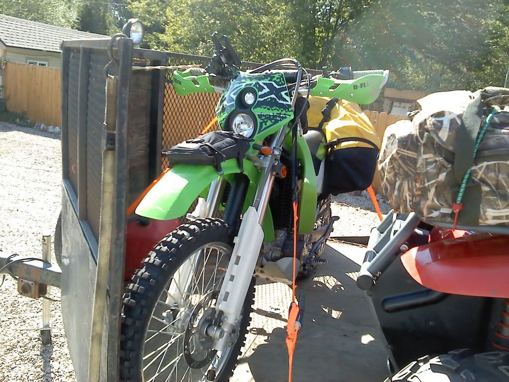

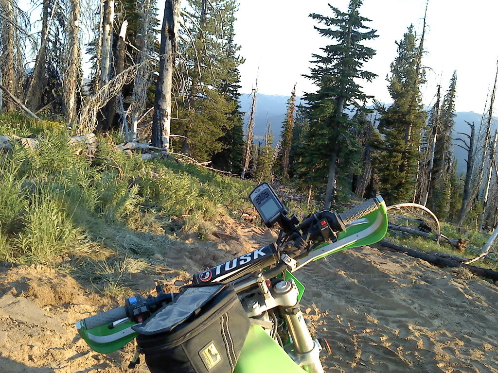

I think you're correct and I should have been more clear, but wanted to show what the aluminum bar looked like. This pick shows the Tusks with aluminum bar, green plastic handguard shield, and black spoilers (pretty good wind protection).
These ones show without the black spoiler
edit: I recall others saying that the tusk handguard aluminum bars aren't the strongest out there and have bent on occasion. Same goes for the Tusk handlebars but I've used them on the KLX for nearly two years now. My Tusk handlebars and handguards have taken several good falls with no bending, but I don't ride and crash as hard as some others around here. You can see some pretty good scuffing of the left plastic on the pic above with bike on trailer. Barkbusters are claimed to be stronger, which is why they went on the KLX and the Tusks moved to the KLR.
