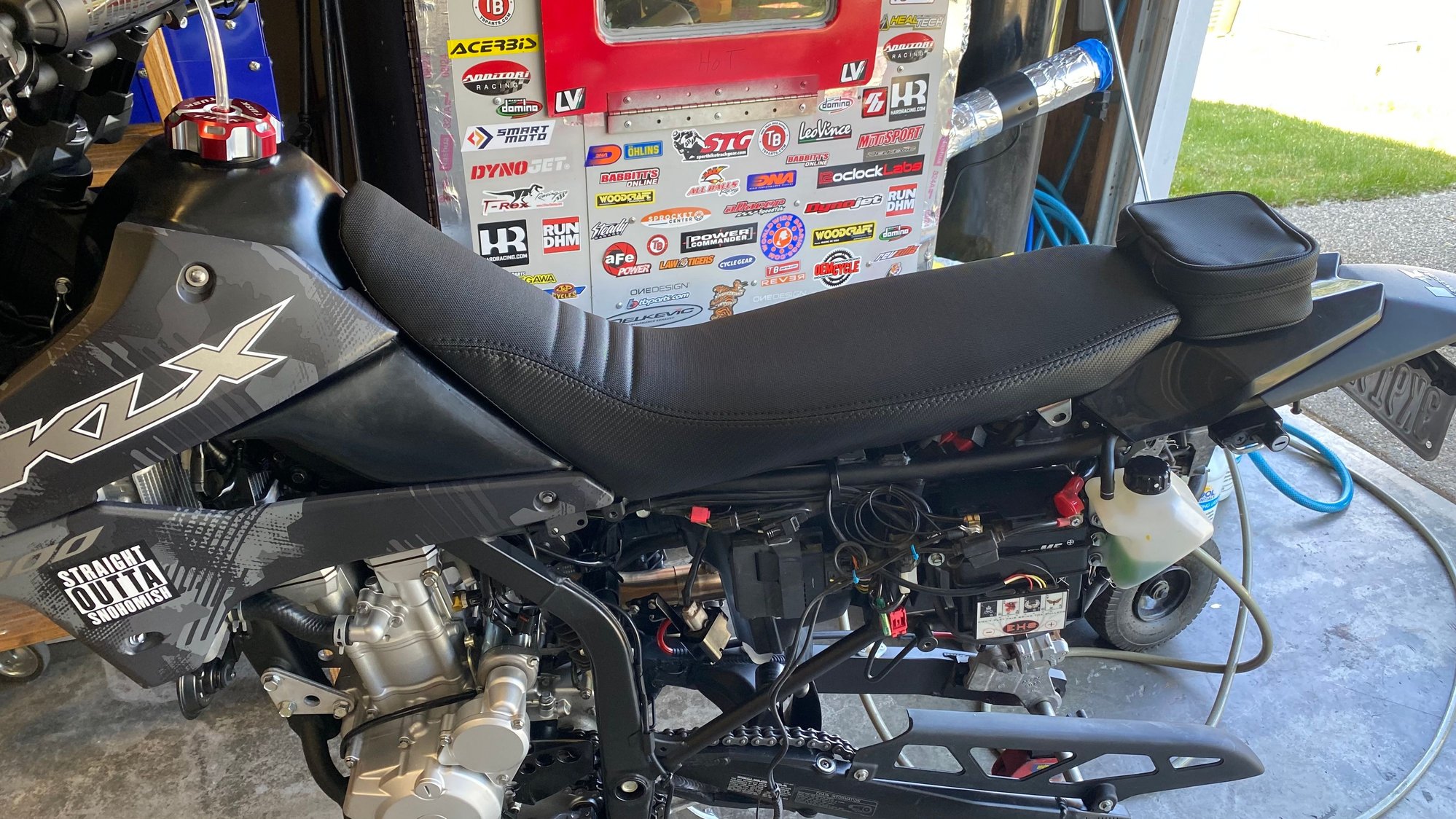

The swap was completed yesterday. Kyle and his friend Dave showed up and I got to work. Swapped the rear tire and shock first. Everything went smooth. Then swapped the forks, brakes ect. Bleed the front brake. Then onto the side stand. This is where the two bike were different. They had different size bolts for the side stand. We had to drill the outer hole in the DS side stand to accept a sleeve from the SM bolt. Took about 5 min and everything was great. Kyle (who is 6’2” ) fit so much better on the taller DS set up. He went on a test ride and was super happy. We loaded up his bike and off they went. Then I got to work on my swap. Everything went smooth but ran into one small snag. The stock 106 link chain is too long to run with the 37t rear sprocket on the SM wheel. So I broke the chain and took out three links. I ordered a new master link and it should be here in the next couple hours. Then I can take it out for a ride. I love the look and it lowered the bike to a comfortable level for me (5’ 8 1/2”) . Also installed the seat concepts foam and cover.
