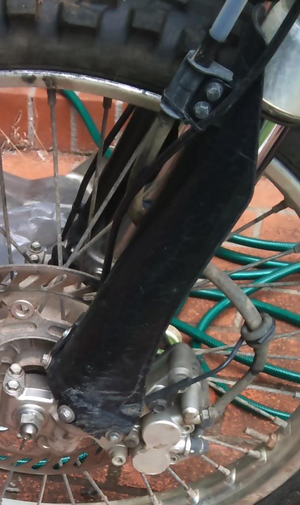

Too late I'm afraid I've already changed the line, but I had these old photo's:
Original routing:

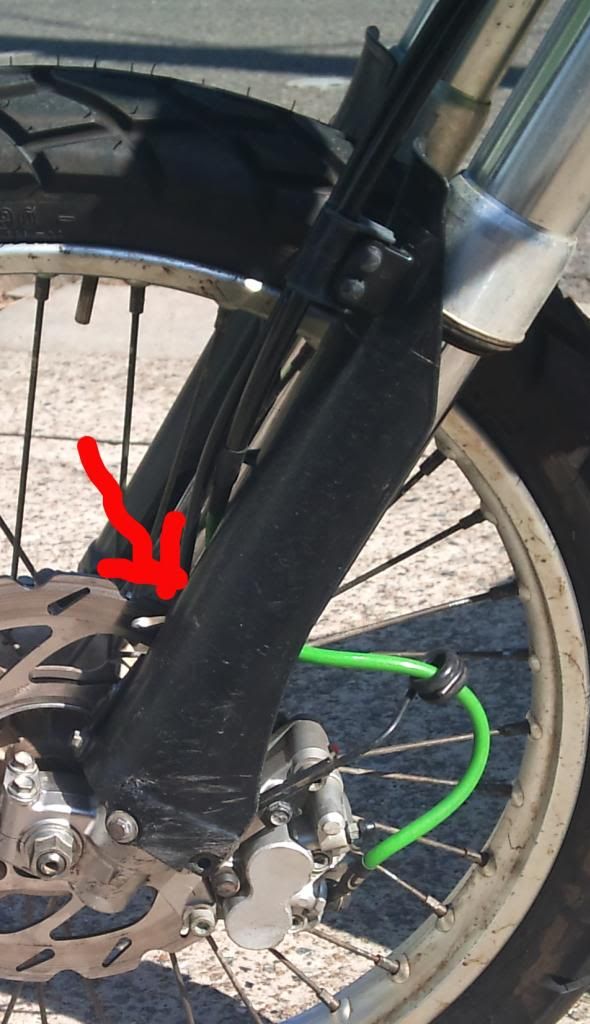

Routing of my braided steel cable (exact same path as original I thought):
The red arrow shows where the disc rubbed the cable. I can only assume that happened when the plastic fork guard flexed over bumpy terrain.

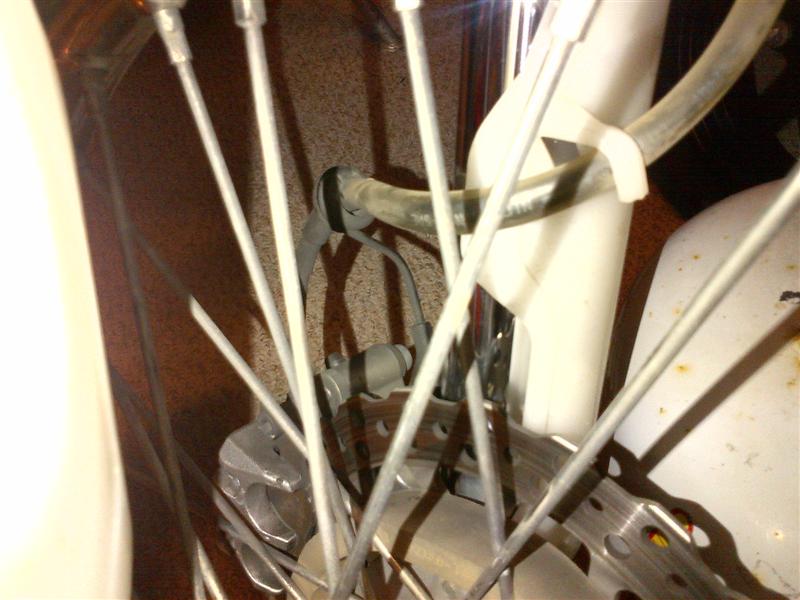

I have a 2009 and the hose is pretty far away. Your green one looks like it needs to be pulled further up through the clamp at the top of the fork guard.
Attached Thumbnails Check your front brake line!-img-20130930-00575-medium-.jpg
Agreed - I did not install it properly. Just thought that it's a simple mistake others might have made and the consequences could be dire.
