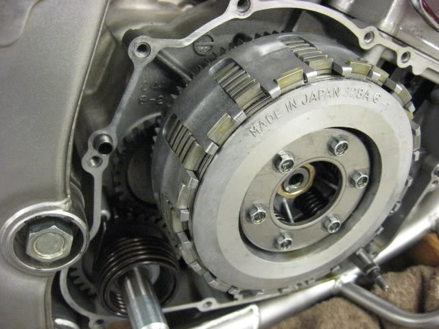

I believe mine has 7 friction plates and 6 steel plates....but that doesn't do much to answer your question.
