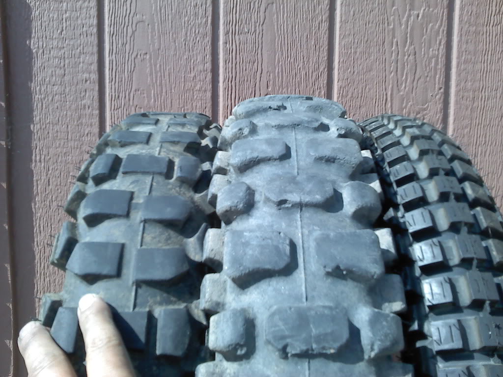

We've discussed numerous times the issue of using bigger rear tires on the KLX. I've been a proponent of using smaller tires that are close to the stock size to preserve the meager power supply on even modded KLX's. I've been using the Kenda 100/100/18 rear TrakMaster with excellent results. I have 14/47 gearing and a 300 cylinder with a full Muzzy exhaust. I've used this bike with this setup in Utah and Colorado on previous trips with no problems.
This recent CO trip I tried a Kenda Parker desert tire on the rear in a 110/100/18. The Trakmaster in the 100/100 is actually a tiny bit shorter than advertised while the Parker is a tiny bit bigger than advertised. Oddly it was enough to cause me to use 1st gear a whole lot more than on other trips with with the 100/100 Trakmaster. There was just the tiny bit of taller gearing that actually made a difference in what gear I could pull in really steep, tough conditions. These size differences don't sound like much, but it was that tiniest bit of increase just enough to affect gearing subtly. I even had to drop the DJ needle one notch, something I'd never had to do in the past on any CV carb equipped bike. What I really needed was to go to a 13T front sprocket, but I didn't have access to one at this point.
The trip and riding were still great, but I struggled a bit more with slower speeds having to go to first more frequently and more quickly when the bike was running higher up and on steeper grades. I just mention this to point out that rear tire size increase can really affect a bike's performance as it applies to gearing. If I'd gone to one of the 130 or bigger size tires that are often discussed here, performance would have suffered much more. Even when you gear down the bike some more, you're still trying to spin a bigger, more aggressive tire on a relatively small displacement, lower powered bike. In southern Utah/Moab type conditions, this 110/100 tire probably wouldn't have made as big a negative impact, but high altitude and really steep, rough conditions really took their toll. The tire tread design and traction were great. It just needed lower gearing at the very least.
I just mention this to point how important that discussion about rear tire sizes can come into play on our KLX.
When Darren and I were going by Montrose and Gunnison on the way over from changing camp from Silverton to Creede, I called a couple of shops to check on a 13T, but obviously that was wishful thinking. Truthfully, I think I'll just go back to the Trakmaster 100/100. I've had nothing but perfect results with the last 4 or 5 or those tires, so there was really no reason to try something else except out of curiosity. That's not a knock to the Parker. It's wearing extremely well, hooked up excellently, and looks like a great overall performer. They just don't make a 100/100 in it. In some reflection I would still probably benefit from a 13T on these CO trips. A 13/47 would probably be pretty neat for there, and I avoid high speed pavement as much as possible anyway.
