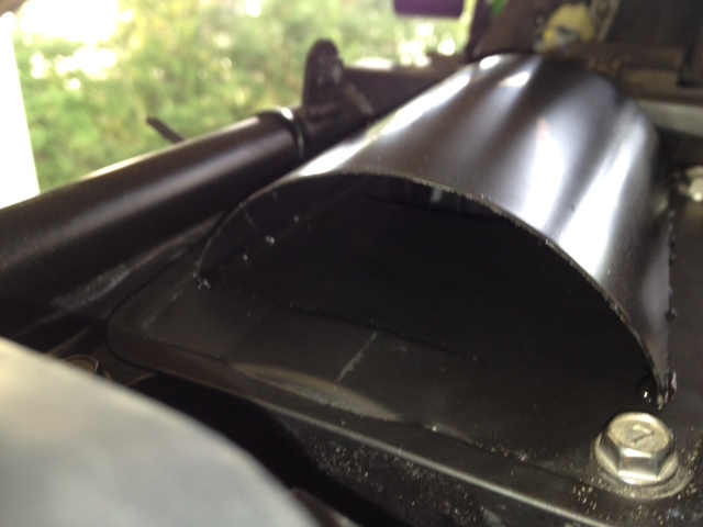

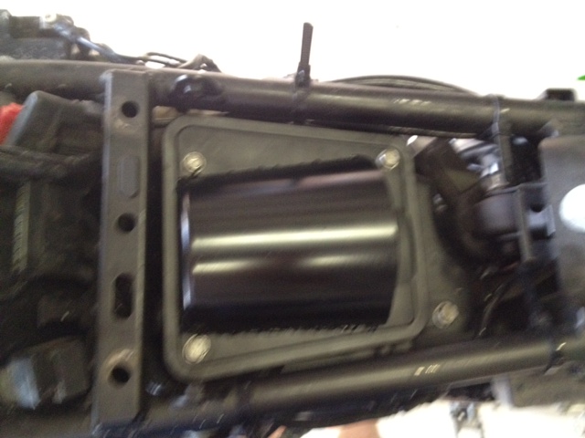

So after riding around a few months with no air box snorkel and too cheap to order a KDX snorkel I decided to fab one out of stuff I had laying around the shop. I was tired of getting water in the airbox and I realized that if there isn't anything directing the air into the box at high speeds you could potentially be creating a vacuum. So let me know what you think about it, I know it may be a little ghetto rigged but its nothing permanent so no harm no foul.

It's mainly so water stops going into the airbox if it gets rained on.. I'm still waiting for the silicone to dry so I haven't ran it yet, but if doesn't do anything than whats the point of using a KDX snorkel? It's directional flow with more volume. I also just ordered a K&N should be here Thursday.
that is how my bike was until i installed the k&n....with the k&n, it runs better and the vibrations go away with the kdx snorkel on my bike...
