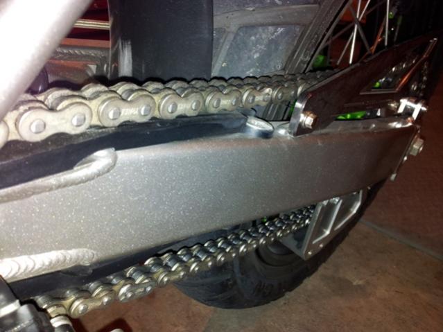

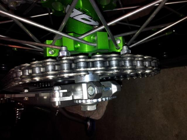

Anyone know where I can find a 38 tooth rear sprocket. Already running a 15 tooth up front. Bike pulls hard enough with the 15 so I think I can go one more tooth to get a better top speed.
sf oem 39 is the smallest that fits and already touching the guards...also, smallest listed i found was the 39t for the klx250....
you can go remove the chain saver and go with a 16t front and replace the rear with a 41t rear...that should be just about the same...

They have them, I had them make me a TI in 38 tooth. One tough sprocket!
so the 38t fits without grinding down to your swing arm?...even with a 13t/39t setting..i was grinding down my chain guard a lot...

The can guide on the bottom, or guard up top? I have a Zeta chain guard off a DRZ 400.
No, you're right to be concerned with this. Most of the OEM sliders are too soft for more aggressive chain contact caused by sprocket changes. However, a better aftermarket guide/slider usually alleviates this. They seem to be much more durable. I'm not personally familiar with how this particular sprocket change for the SF will work out in this case, but you're definitely right in considering guide/slider wear in any case.
I have an 06 250s and ive been running a 15/42 and i have to take the case saver off to run the 15 . There is barley any more room on mine . not enough to run a 16. Maybe the older bikes are different then the newer ones??
