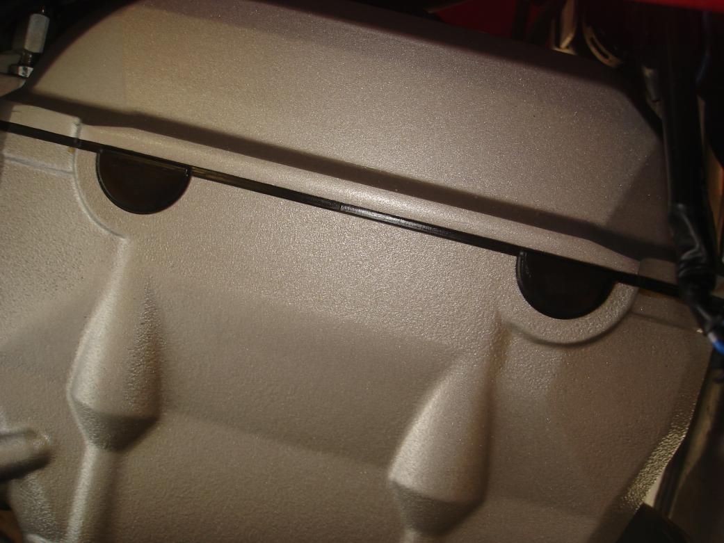

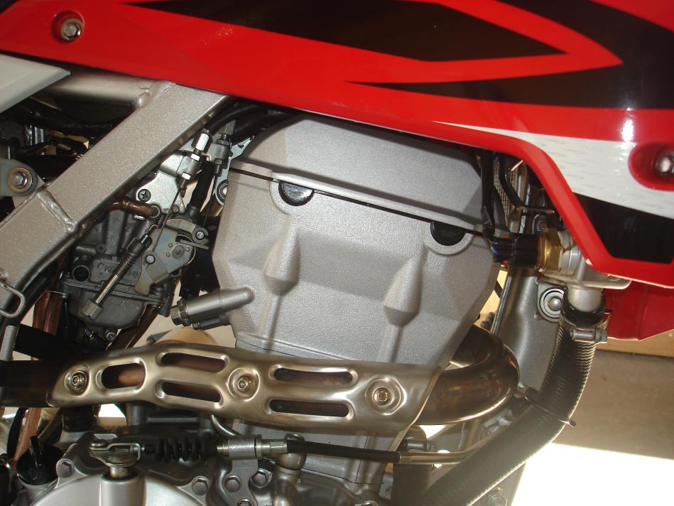

Old Dec 16, 2010 | 11:02 PM
evanbdenver's Avatar
Joined: Dec 2010
Posts: 1
From: Denver
Default KLX 250S oil seeping from head gasket?
I would appreciate some help. I have a similar problem to AGIRLS. I noticed dirt buildup around engine and cleaned it up, then found oil leaking from two black semi-circle rubber seals on the main engine. Pictures attached to post. The oil leaks only when engine is running. Clean oil is oozing out around the two black semi-circles. No leaking from other side of engine around the black gasket, or from oil fill cap.
I'm handy with lots of things but not motors. Is this a bad head gasket? I did think about whether the oil was over-filled and causing too much pressure.
Any tips on what I should do? Drain and add oil at the specified amounts (1.5 qts, 10W40)? 2400 miles, 2009 model purchased new in June 2008. Some off-roading on trails, and roads, but mostly street driving.

Old Dec 16, 2010 | 11:36 PM
linkin5's Avatar
Joined: Sep 2010
Posts: 988
From: Indiana
When you check the oil in the window are you standing the bike strait up and not leaving it on the stand. The problems your having sure look like an over fill situation.
That's not your head gasket, it's the valve cover gasket. It's simple to fix. Just have to take off the valve cover, clean the gasket area, put a little Permatex or other gasket maker on the semi-circles, and torque it back to specifications.

Old Dec 17, 2010 | 08:30 PM
  #30
sanpedro's Avatar
Joined: Jul 2010
Posts: 130
Had the same issue with my '09. The mechanic at the Kawi shop said it's because of the way the gasket is designed. I guess a lot of gaskets have a T shaped cross section, with a little bit on the bottom that fits into a groove and helps keep the oil in. The KLX valve cover gasket is just a flat strip that is sandwiched between the two parts and it's easier for oil to bypass it, especially at the semi-circles where the cams are. He used the black rtv silicone last time I had my valves checked and that seems to be doing the trick.
