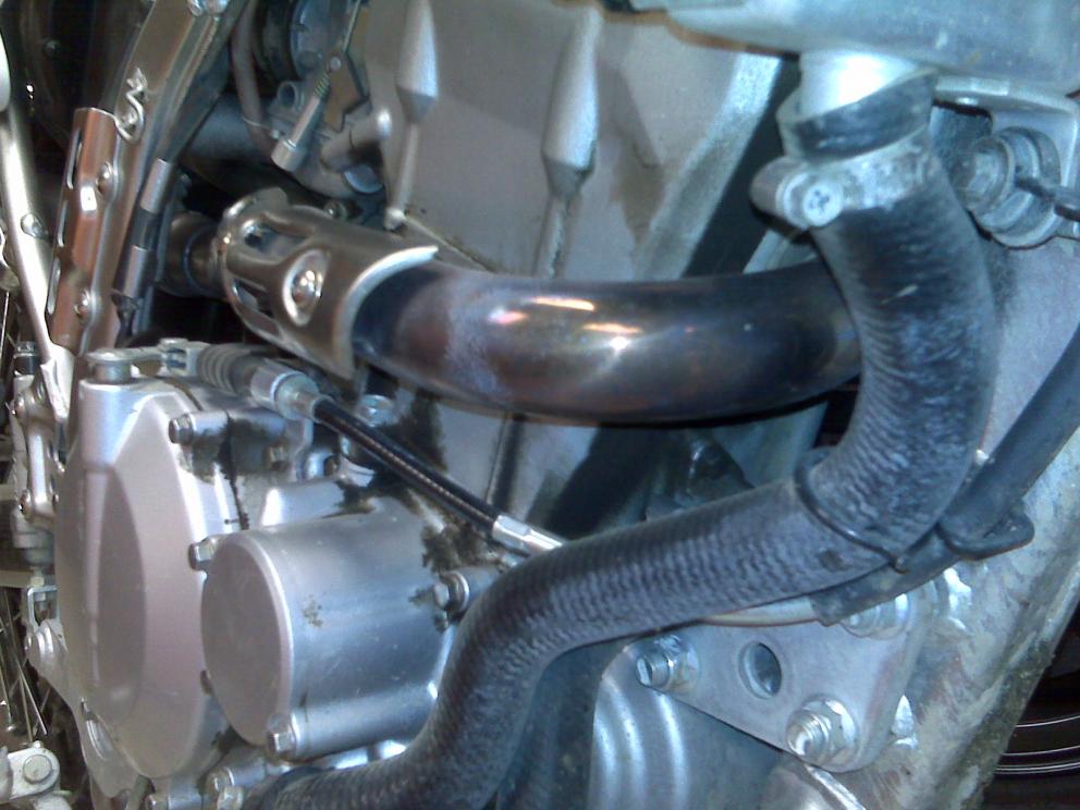

Be more specific or take some pics at least. The only seal I know that leaks on the 09's a lot is the valve cover seal. I guess it shrinks up and starts to weep. Other than that.....

Just the 09s have the leaky VC seal? Figures. None of my dirtbikes have ever leaked oil. Ever. I would investigate the crankcase breather hose to be sure that you don't have a blockage in that system which allows the pressure pulses to escape the crankcase.

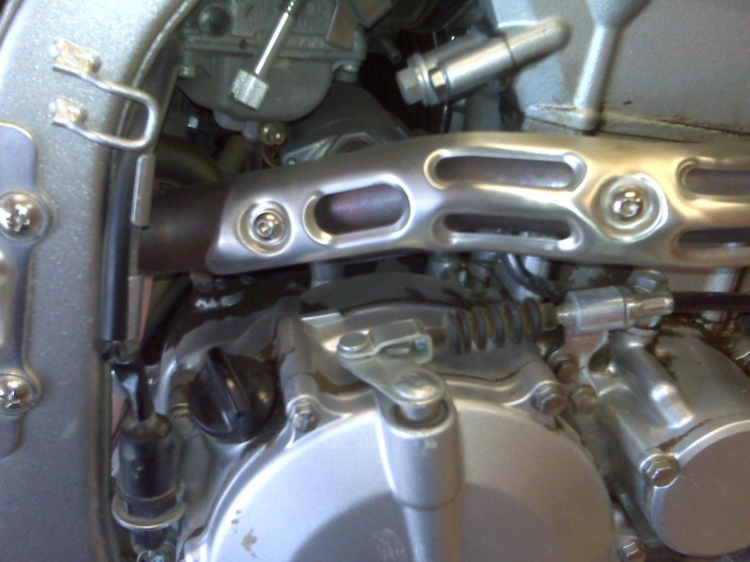

I've attached 2 pictures that I took with my cell phone. I wiped down the side after the last ride so it is not as dirty as it usually is but there is plenty of other dirt to see. The valve cover is definitely leaking as well as other things. So I take it it is not normal.

Are you sure it's not coming out of your oil filler cap? Maybe that's loose and the oil/dirt is accumulating around the engine. Just a thought...

The oil also runs down the side (I had already wiped it - sorry) so I'll start with the valve cover seal and the o ring in the oil cap. Thanks!

make double sure you don't have too much oil and its building preasure.

Is the crankcase breather clear? Have you de-restricted it?

+1 what WEDGE said about too much oil and checking the crank case vent tube (not kinked etc) Have you gone over all of the bolts to make sure they are tight? (You don't want to crank them down too tight though).
I put a very thin layer of high temp silicone on the valve cover gasket (both sides) when re-assembling. Not one leak.
