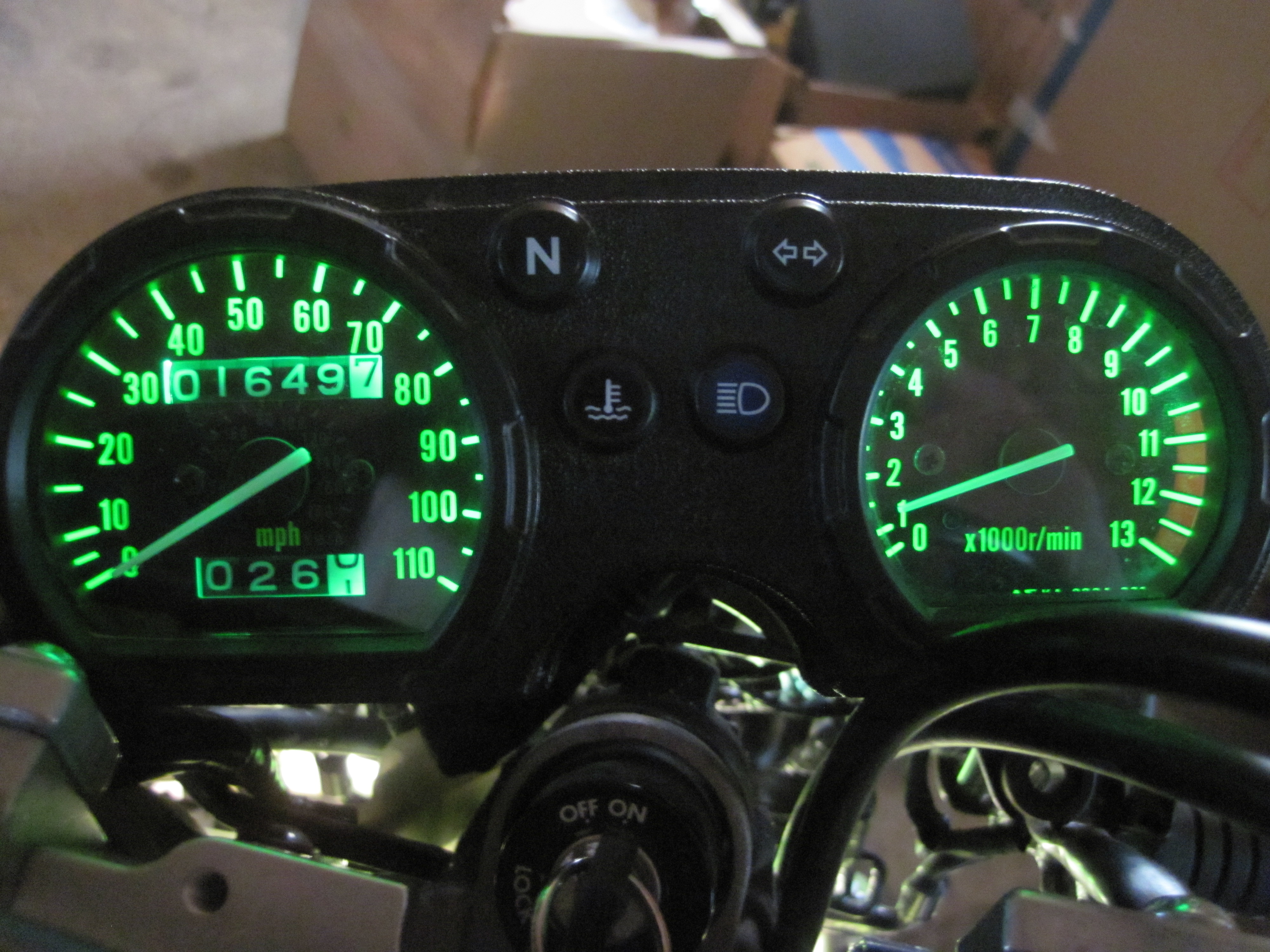

I got some of the LED lights installed. I'm still debating on which color to go with on the speedometer and tachometer.
This first picture is cool white and seems the closest to the factory color.
Attachment 9584
This one is cool white on the speedometer and green on the tachometer.
Attachment 9585
This last one is green on both sides.
Attachment 9586
I think I like the cool white. I'm going to do some riding at night to see which color I like best. I did this in my garage with the lights off trying to see what I liked better. I think a riding test at night will determine the color.
