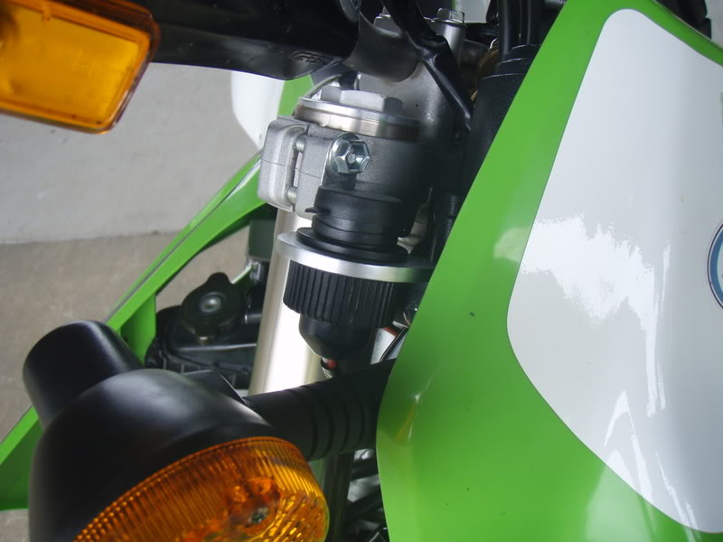

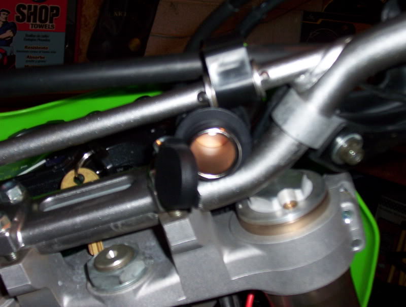

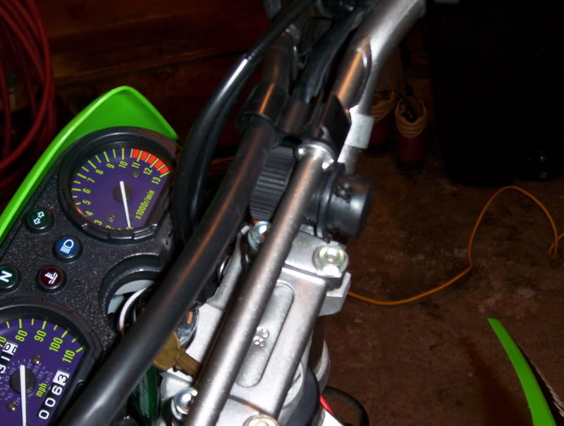

Well as some of you know, a year or so ago I installed a 12 v plug on the bike for whatever I needed it for, but now in thinking about my trip to Canada, and the smaller tank bag I picked up, the location was causing the cell phone plug to hit the tank bag. So here are the before pics and then a couple of relocation and new bracket pictures. Now I can have the charger through the cables and down out of the way and now the tank bag is free from hitting anything.

I used a CB antenna bracket cut down a drilled to 30mm. Worked perfect.

I ran a new fused wire all the way to the battery. I didn't want it on a key switch.
