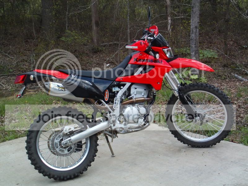

***UPDATE*** New brakes, new back tire, and of course detailing! ***UPDATE***

WOW! Your bike is almost as clean as mine. Man there is something awesome about the red bike. I think secretly we all love red because it reminds us of the old Honda days........well if you are old enough to remember the Honda days Looking good man.
the "shark finned" remark was in reference to the bend on the front sprocket teeth Deej. Not only that but they seem to be spreading out some. Jsac could be right. Maybe it's just the picture.
Oh I see. Well as I looked at it, and remember that pictures can distort the real thing, the teeth all looked perfect and not pulled back at all.
Sorry deej, but I'm with lcpl0331......It looks like you are due for a new set of sprockets. BTW....Is it true you should always replace both sprockets and the chain at the same time? Is there a time when you can get away just replacing one of the three? I've always wondered what is the proper approach.
i just replaced all on mine.. it makes sense that bad wear on one component would transfer to the others. if only one component is replaced versus all you would speed the wear on the new part as the others wouldnt seat quite right..

Mudjunkie: You could get away with replacing just one component out of the setup if that's all that's bad. If you're using the stock chain, REPLACE everything. Its a POS, I don't care what IG or others say. But if you invest in a good, gold-plate chain you could get away with changing just the sprockets as long as the chain isn't stretched.
