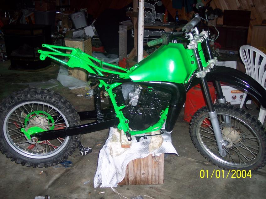

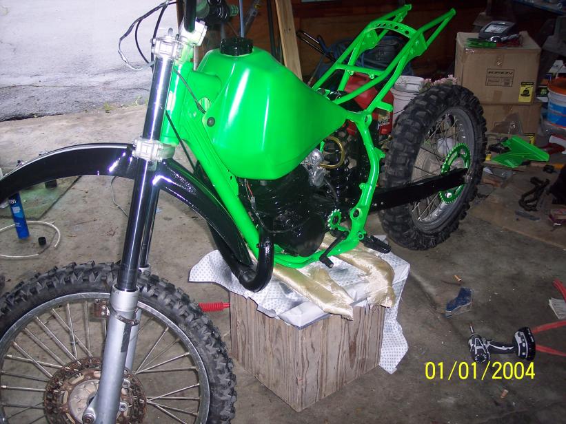

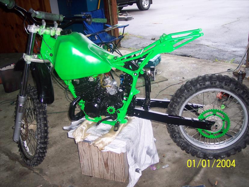

any sugestions welcomed
Attached Thumbnails 88 kdx 200 making hill climber-green-machice-002.jpg   88 kdx 200 making hill climber-green-machice-004.jpg   88 kdx 200 making hill climber-green-machice-001.jpg

I do not have any 'snake bite formula' on this ride, but get the suspension set up.

put a good pipe on it and reduce the piston/head clearance for optimal squish clearance. download my squish calculator from Squish Band Velocity Calculator

also thoe old ignition systems were weak. Get a high voltage coil for any Honda CR which are the strongest coils. Good used ones are available on EBay. Also get my adjustable CDI: Adjustable replacement KDX 175/200/220/250cc CDI
