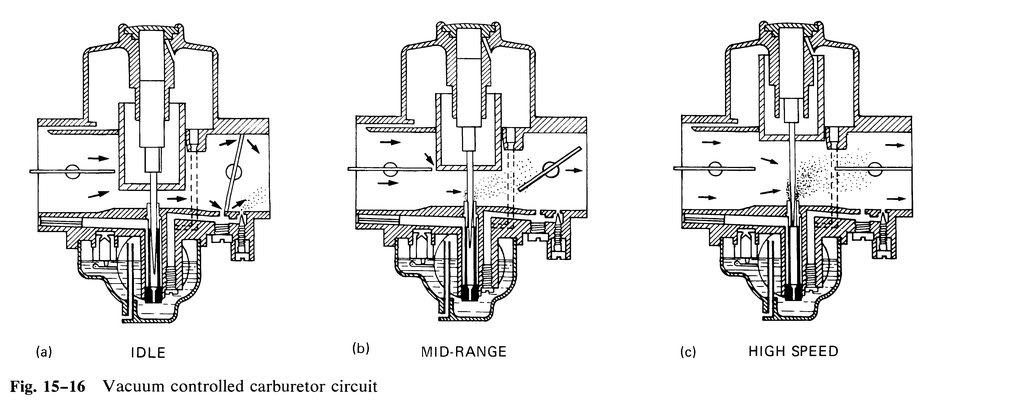

do u mind clarifying on what the low speed circuit is? and im pretty sure i gave the carbs a thorough cleaning. i drained the bowls prior to storage. the thing is the bowls have fuel in them and i have spark but when i pull the plugs them come out dry....i think they should b wet so there might b a problem with the suction system? just throwing that out there. thanks

Vacuum leaks are probable, and so are blocked fuel passages. The fuel inlet needle and seat are prone to clogging for example. Pretty much a process of elimination.
edit: Hope you checked the fuel filter and the fuel tap as well.

cleaned the fuel tap(petcock?) and fuel filter is brand new..i actually added the filter..bike didnt have one before. thanks for the diagram...i pulled the carbs again to clean them...is there a standard preset for the pilot screw??????
