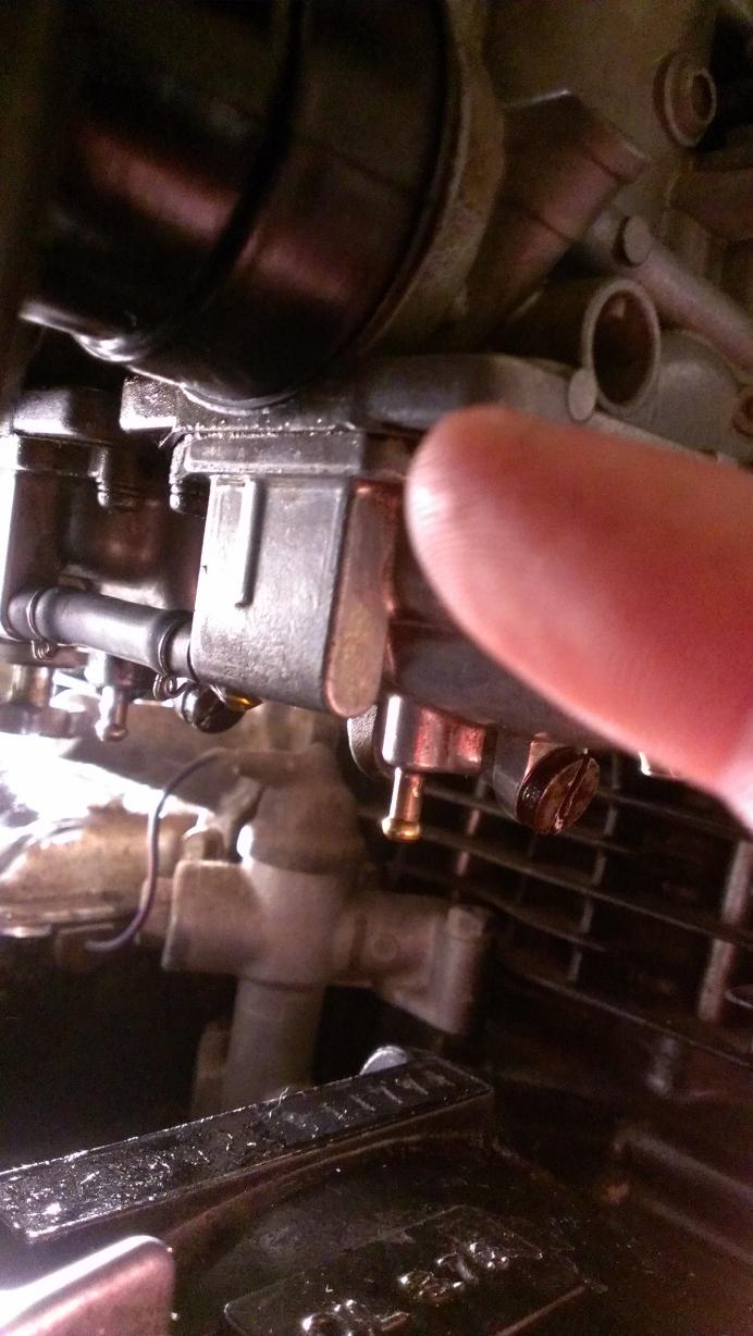

Hi, and thanks for the excellent info! According to the second quick flip owner of the bike, he purchased it from a widow whos husband was the original owner of the bike. He died, the widow stuck it in a barn and there it sat until her grandson had some sort of carb service done on it to get it running. I test drove it before purchase it started and still starts right up when I want. It idles good and runs good at higher rpms as well. I will take some pics later so I can get you details on where the drips on the carbs are coming from so you can help in more detail. And I greatly appreciate your willingness to help my man. If it wasn't for the internet I wouldn't have learned half of what I have already. No leaks of any kind under the bike , just carb drips and petcock. Sorry if my thoughts aren't organized and my typing is bad , I am using swype on my smartphone and waiting for my rig to get loaded, I, work as local p and d for a freight company in the Chicagoland area. Thanks again!
I'm thinking the petcock issue is related to your carburetor dripping issue. That packing / lil' round disk thingy with five holes in it in the rebuild kit picture crumbles into tiny little pieces and they make their way into the carburetor float bowls where they work perfectly to hang up the float needle and let gasoline overflow from the carburetors and instill fear and regrets for buying the bike in the owner. Stay brave.

Hi, Hopefully these carb pics are useful. I tried to point at the fuel moisture and drip areas to specify the problem areas. I can get specific on which number carb each picture is if it is necessary for diagnosing anything. Time to make the doughnuts now......Thanks!
