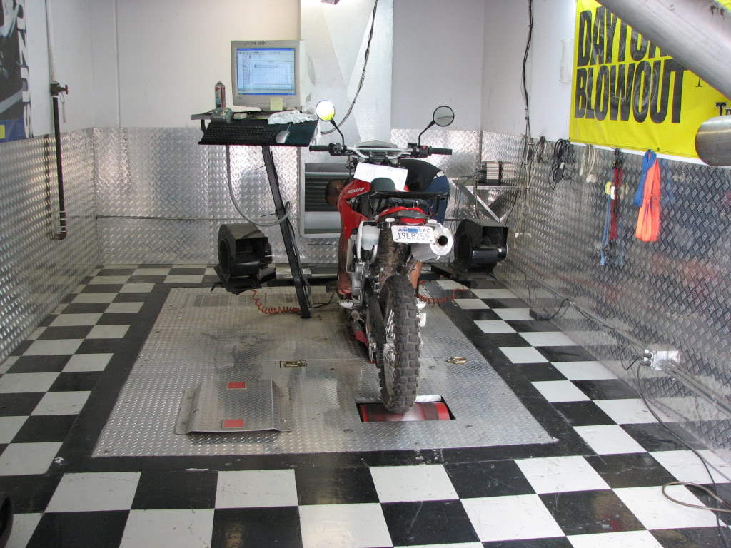

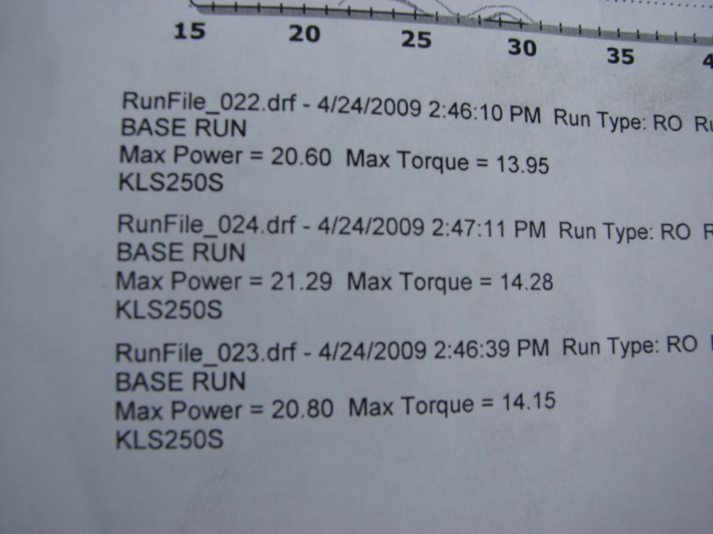

Me and my buddy got our bikes dynoed today! My bike is an 09 KLX250S with a full muzzy exhaust, uni air filter with no lid on, pilot jet is 38, nt1c needle at the 4th notch from the bottom and and keihin 138 main jet. My buddy's bike is a completely stock 08 WR250R. His bike used to smoke me until I did my mods! Now the only time he would pull away is at around 65mph. But then again, his bike is stock and has a lot of potential! I'm glad I got to see my air/fuel ratio. I was running very rich midrange and at top end!
Here are the results for my KLX:

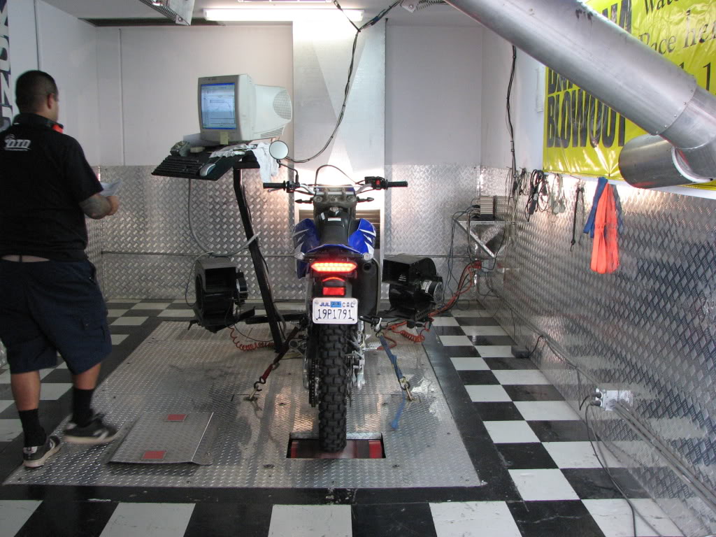

And here the results for the WR250R:

Here's the video of the KLX on the dyno!
And here's the video of the WR250R on the dyno!

As you guys can see, the WR is pretty powerful in stock form! But if you look at the torque differences, it's not much! I love the way my bike runs right now but it will get better once I get the jettings right! I love my bike!
