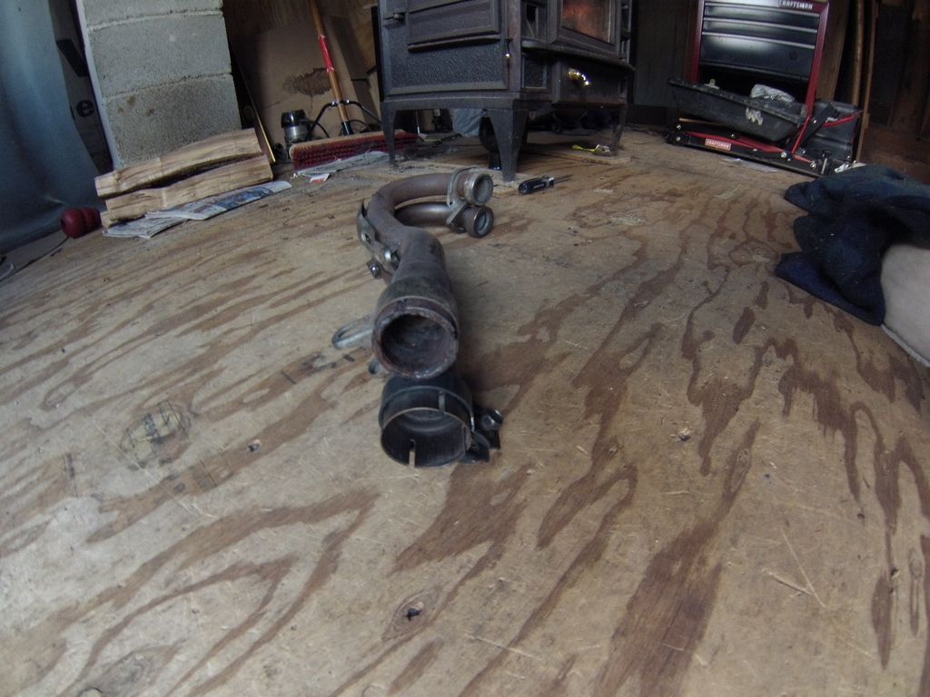

Not the best pics but I was using a GoPro and couldn't see the results.
Here you can see the length difference. The pipes are the same diameter over most of the length, until you get to the flange.

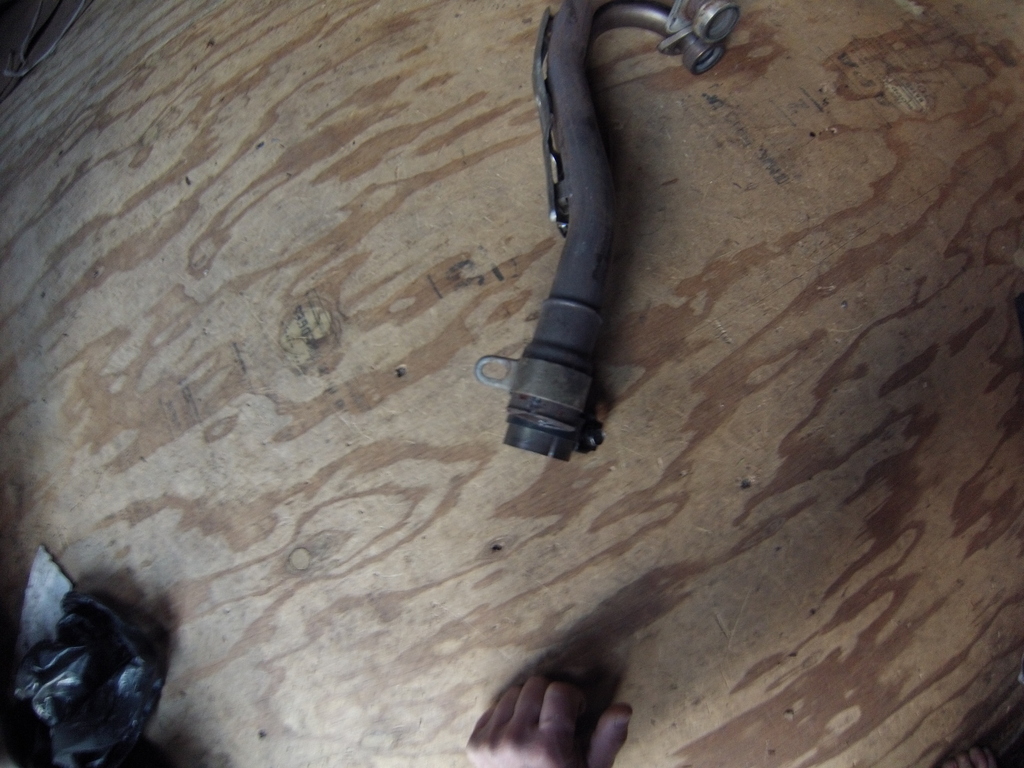

And another showing the length difference.

The 250 pipe fits inside the 300 with room to spare.
If you want to revert to the 250 set-up, I would have a short piece of pipe expanded on one end to fit. If there is no going back, then cut the header and add on the appropriate size flange. Or find a 300 header. At $38 for the muffler, well lightning may strike twice.

Thanks a lot for the pics! There is quite a difference in lenght and diameter. I have the impression one would need the 300 header as well.
